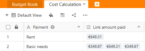

First of all, you need a column of the type Link to other records. Make sure that the option Allow links to several rows is activated, because only then you can determine relations between numbers.
The Formula for Link column then uses the rollup formula to show you the selected relation of the numerical values within the link column. In this example, we have chosen the Sum evaluation method:

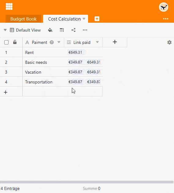

Add a table link
Read in the article about the link column how to create a column of the type Link to other records. This is a basic requirement to be able to use the rollup formula.
Using the rollup formula only makes sense if you enable the Allow link to multiple rows option when creating a link column. If the option were disabled, the field of the rollup formula would always contain the same value of the link column.

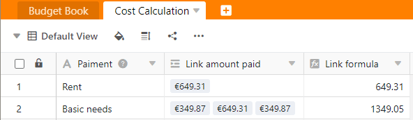

Create a column with the rollup formula
- Create a new column of the type Formula for links.
- Set the Rollup option as the formula.
- Select the link column that links to the desired table.
- Now decide which column from the desired table you want to link and evaluate in the Select column to be merged field in the linked table.
- Set the evaluation method. You have average, minimum, maximum, sum and concatenation to choose from.
- Click Submit.
