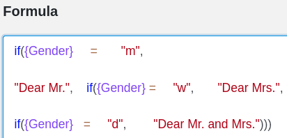

Don’t be afraid to use spaces and line breaks when creating formulas. These help you keep an overview of the individual functions and other elements, especially in more complex formulas.
You can set spaces and line breaks almost arbitrarily in the formula editor. Caution is only required when using functions. Directly after a function, for example lower(), no space must be set.
Spaces and line breaks can be set almost arbitrarily in the formula wizard. The only exception are functions.

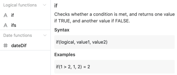

When you click on an element in the formula editor that you want to add to your formula, helpful information is displayed. Directly under the name of the selected element, in addition to a brief description of how it works, you’ll also see a possible syntax and a concrete example of how it might look in a formula. When writing more complex formulas, this information can be useful to avoid mistakes or uncertainties.
Information about an element in the formula wizard
