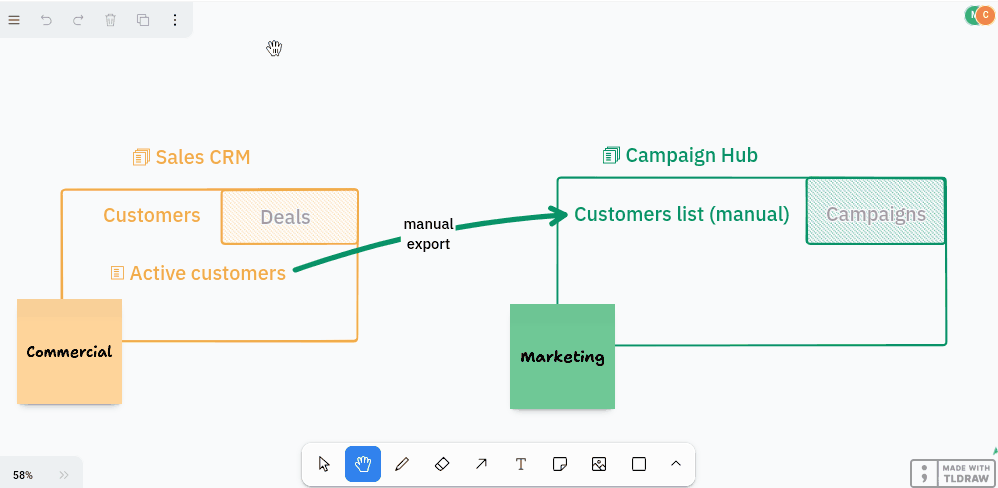

Marketing keeps a board explaining how the customer data reaches them — but it still shows the old way, back when they worked from a manual copy. Now that the data arrives as a common dataset, the picture needs redrawing, and since you set up that new flow, you will update it together. In Malika’s window 🕶, import the following base into the Marketing group — you are both members, so you will both be able to draw on it:
SeaTable Course 3 - Marketing Whiteboard.dtable
The whiteboard plugin comes already set up inside it, with a starter diagram already on it — so there is nothing to install; just open it from the base’s plugin area.

With the board open in both windows, you are on one shared canvas — and the two of you are present on it at the same time. That live side is easiest to feel if you tile the windows side by side: in your window 🌐, move your cursor across the board, run the laser pointer along a shape, or leave a short message under your cursor — then glance at Malika’s window 🕶 and watch each one appear there as it happens. The traveling cursor, the fading laser trail, the brief message: this is the in-the-moment collaboration a table cannot give you.

So before you fill it, agree on a simple convention — the way a team agrees on naming rules for its data. One lightweight scheme works well:
- one color per person or department, used for your own additions — since the board keeps no log, the colors are how you tell afterwards who did what;
- draw data and structure as rectangles, and represent people as notes — a sticky note names who, with a date or a done-marker if useful;
- group what belongs together inside a no-fill rectangle, so a glance shows the shape of things.
This is only a starting point — your team may settle on its own. The point is that the board carries its own “who and when”, because SeaTable will not.
Update it together
The starter board still shows the old way: the customer list reaching Marketing through a manual export into Customer list (manual). You spent this whole course replacing exactly that, so bring the board up to date — together, live, each in your department’s color. The change is deliberately small; the point is doing it side by side, not the drawing.
| Window | What to change |
| 🌐 You (Commercial) | Rename the arrow to common dataset and repoint it to Customers (live), then add a blue note for Commercial by the source — the new path is yours. |
| 🕶 Malika (Marketing) | Mark Customer list (manual) as no longer used, and add a green note for Marketing (Malika) on that side. |
A minute’s work between the two of you — and because you each drew in your own color, the finished board shows at a glance who changed what, even though SeaTable kept no record of it.
