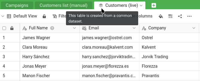

Switch to Malika’s window 🕶. In Campaign Hub, add a new table and choose Import common dataset, then pick Customers (live).
A new table appears, marked with a small stack icon to show it comes from a Common dataset. It contains all 350 current customers — the complete, up-to-date list — and only the safe columns. Next to the outdated Customer list (manual), the difference is immediately clear.
Please note that every synced column is displayed with a sync icon on top of its usual type icon.
