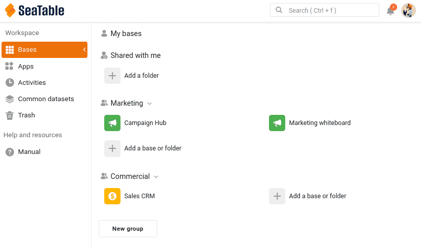

So Malika is in the team, but looking at her home page right now, your Sales CRM base is nowhere to be seen. Let’s change that.

Now switch to Malika’s window 🕶. The first thing she sees is the notification bell at the top right of her home page showing a new alert: SeaTable has told her that a base was shared with her. Refresh the page and the Sales CRM base also appears in her workspace, in the Shared with me section. Open it, and you can read and edit the data — Malika is now collaborating on your base.
