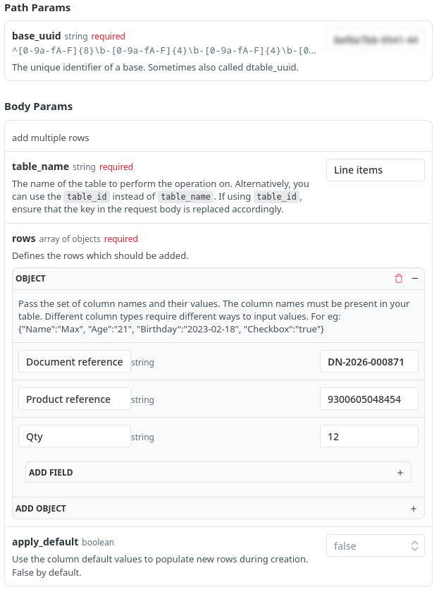

To the right of the form, enter your Base-Token and the server URL — nothing can be sent without them. Then point the call at your base via base_uuid and at the Line items table using table_name. The panel nests, which takes a moment to get used to: rows holds an OBJECT for each row you are adding, and inside it ADD FIELD gives you one column and its value. Below is what a single line looks like once it is filled in.
The settings panel of the append_rows operation on api.seatable.com, filled in with one delivery line
Create at least one row to add. Give it a Qty, and — more important — the two references your linking automation matches on: in Document reference, the Delivery reference of the document the plugin has just created; in Product reference, that of a product already in your catalog.
