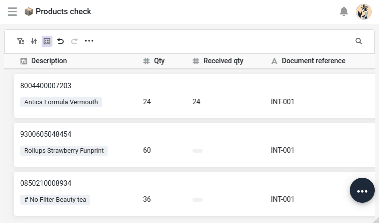

In the field, you don’t receive goods from a spreadsheet grid. Your base ships with a small Delivery check app containing the 📦 Products check page, designed for a tablet. It lists your delivery lines grouped by whether they have been validated, so the ones still to receive sit at the top. Open the app and, for each line, fill in two things:
  • Received qty: the quantity you actually count.
  • Status: the state of the batch — As expected if it’s fine, otherwise Too many, Too few, Missing or Damaged.
Mark at least one line as something other than As expected — you will need a delivery with a problem later in this step.
The receiving app showing the line items to check, with the received quantity and status fields
