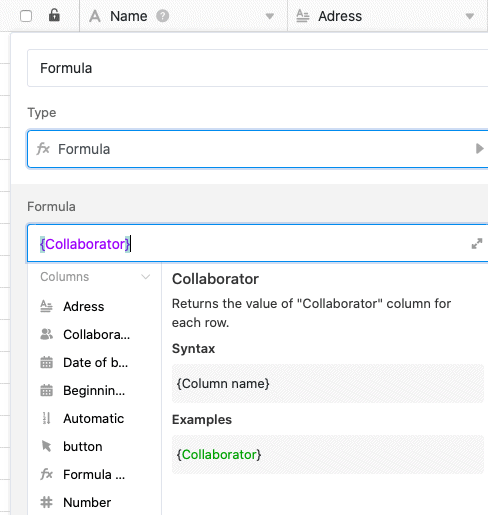

If you define a formula as the first column of a table, you can use the simple formula {column name}, for example, to quote the entries from almost all other columns in your table. This even works if the other column type is not supported in the first column.
Possibilities with the Formula column type in the first column of a table

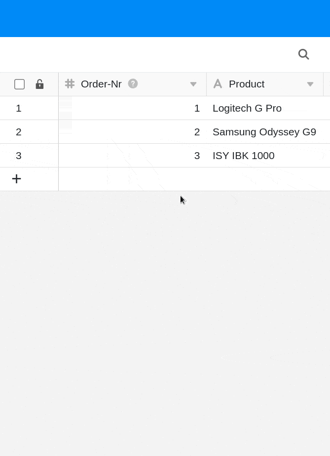

What is an automatic number?
If you want your rows to have a unique identification number, the Auto number column type could serve you well. Examples include invoice numbers, test cases or employee IDs. The number can also be supplemented with any prefix.
