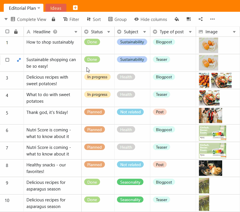

This example is demonstrated in the following video: We are in the view of an editorial plan with numerous posts. First, we filtered the single selection column “Status” for all posts that are not finished. We have further narrowed down this data set using the second filter to only display posts of the type “Blog post”. Now we can see which blog posts are not yet finished.

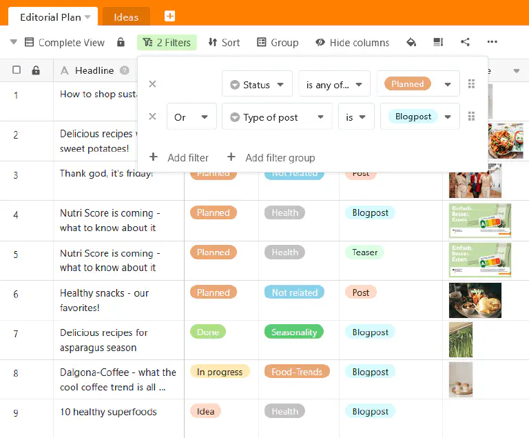

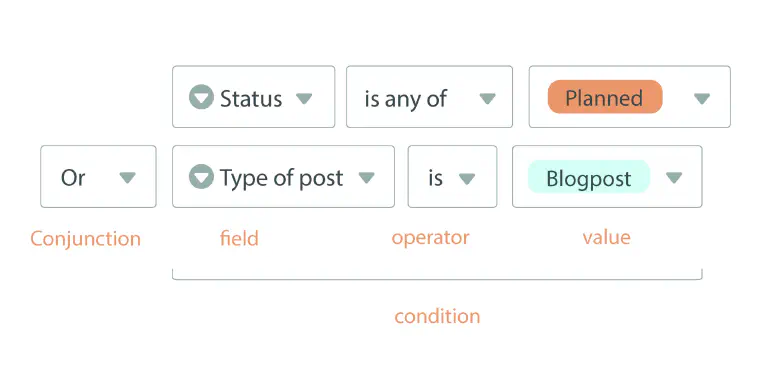

In the case of the OR link, the conditions are independent of each other. It is enough if the displayed records fulfill one of the conditions - but they can also fulfill several or all conditions.
Here is an example (see screenshot): Although we filter for planned posts (“Planned”) with the first filter rule in the “Status” column, records with a different status are also displayed if they fulfill the second condition of the text type as “Blog post”. With the second filter rule in the “Type of post” column, other text types also go through if the status is “Planned”. Planned blog posts that fulfill both conditions also appear in the filtered view.

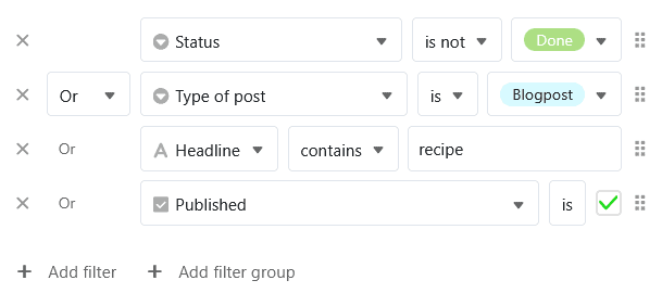

If you define several individual filter rules, you cannot combine the logical and/or links with each other, but can only decide once how all subsequent filter rules should be linked.
And-or links cannot be combined with filter rules

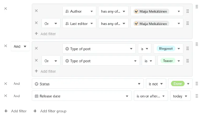

With the help of filter groups, on the other hand, you can combine and-or links. This allows you to implement very complex filter rules that open up countless possibilities for data analysis:
Complex filter rules with filter groups
In this example, the employee Maija Meikälainen wants to filter out all posts for which she is responsible as an author or editor. In addition, only posts of the type blog post or teaser should be displayed. In addition, the posts should not yet be finished and unpublished.
