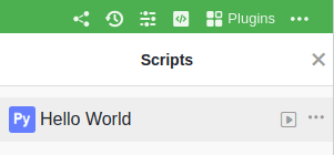

  1. In your base, click  in the base header.
  2. Hover the mouse over the name of your script.
  3. Start the script with the play icon  .

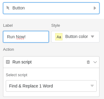

  1. Create a column of the type Button.
  2. Decide which label and color you want the button to have.
  3. Use the Run Script action.
  4. Select your script and save.
Execute script via button
From now on, every time you click the button, your script will be executed. Within the script, you can access the values of row by calling context.current_row. Of course, you can also access all other rows via the rows-ID or by using a loop.

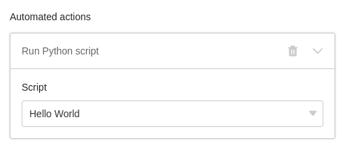

You can use an automation to run a Python script. JavaScript is not available to you at this point because JavaScript is executed in the user’s browser, which is not available in an automation.
  1. In the base header, click  and then click Automation Rules.
  2. Click Add rule and create a new automation. You can get more detailed information on how to do this here.
  3. Use the Run Python Script automation action.
  4. Select your script and save the automation with Submit.
