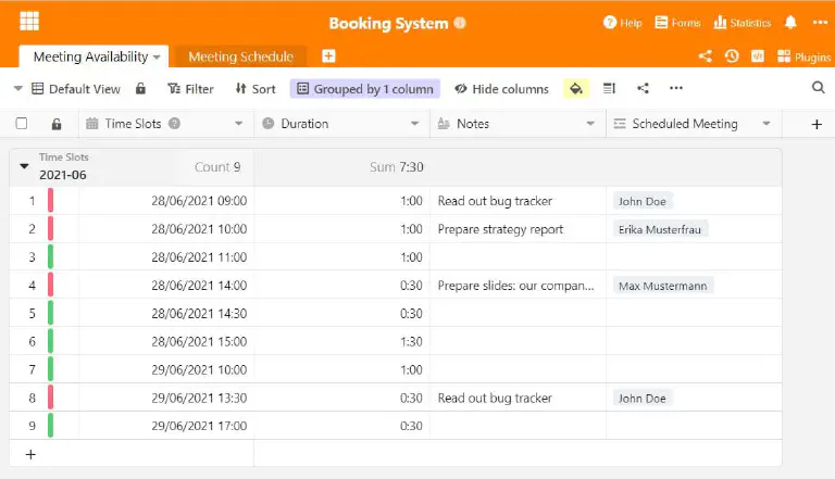

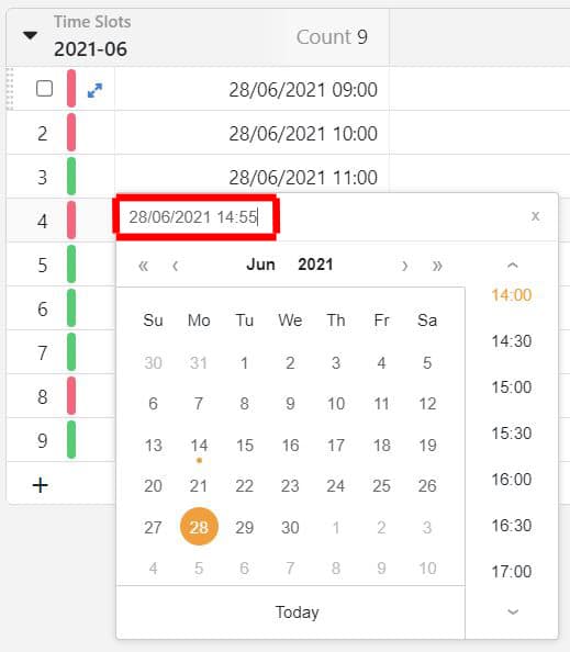

The first table “Meeting Availability” consists of 4 columns. In the first column you enter all available meetings that you can offer. Select the date format with time (move the slider to “accurate to minute”). You can also set manual times that are not displayed in the date window; to do this, enter the time yourself in the bar at the top.
The second column contains the respective duration of the appointment slot you have made available. For this purpose, select the column type “Duration” and set a duration according to your needs. So with the manual setting of the time also 5 or 10 minute slots are feasible.
The third column offers space for your personal notes, such as what the meeting is about, what needs to be prepared for it or what customer information is relevant for the conversation.
The fourth column is linked to the second table. This is easily done with the “Link to other records” column. It contains information about the customer who has booked exactly this appointment and you can directly display all booked participants in your own base.
By the way, with the colour function you can use automated rules to colour rows red if an appointment has already been booked and green if these appointments are still free.

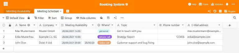

The second table is the basis for your appointment booking system with web form. You can see in the following picture different columns that contain the information of the participants. Each column you create here can be used later in the web form. You can use the column types to directly influence the input of data in the form. For example, if you want to have a free text field, select Columns with text function. If you want to have a kind of dropdown menu, the single or multiple selection is suitable for this. You will see the linked column “Meeting Availability” - so the link will be displayed in both tables with the corresponding information from the 1st column.
This table is particularly relevant for your appointment booking system, because these columns are used to design the booking system

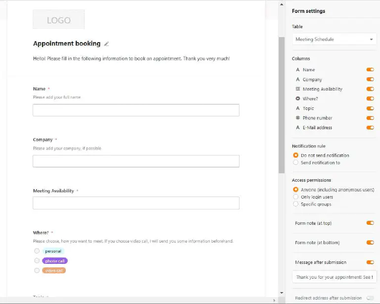

With these columns formed, we now move on to the web form. To do this, select “Forms” at the top, and then create a new web form with the “Traditional Form” setting. Here, the participants cannot access the table and the data themselves. A form mask opens, where you can now label all the columns to be displayed.
Select the table in which you have created the columns for the information query (here: “Meeting Schedule”). You can choose which columns should be displayed in the form. Here it makes sense to include all columns in the form. You can now declare each input field as a mandatory field or add a description text, as well as insert your personal company logo as a header. This way you get your very own personal appointment booking system.
In the web form you can set up your appointment booking system according to your needs.
You can label your form entirely according to your wishes. Information in the form of form notes gives participants helpful hints about what to look out for in your appointment booking system.

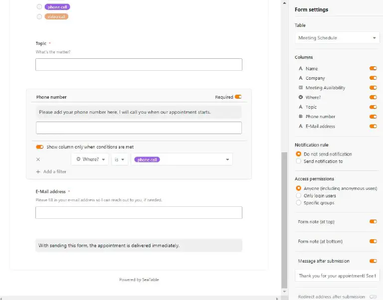

You can also attach conditions to choices. In our example, there are three ways to hold the appointment: In person, by video call or by phone. In case of a phone call, the number of the participant is mandatory, therefore the Phone Number column was conditioned to appear only when the Phone call option was selected.
Columns can be linked with conditions. They only appear when a certain input has occurred.

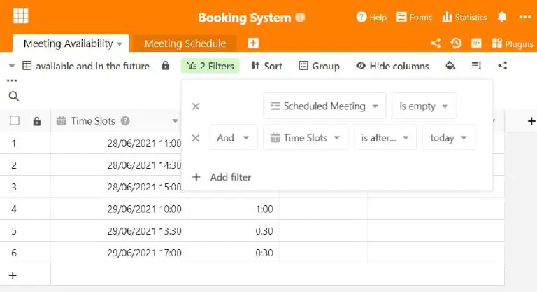

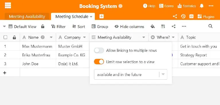

With SeaTable, on the other hand, only a few small steps are necessary to set up your appointment booking system for this. First of all, it is important to create a second view for the appointments in table 1 and to provide it with two filters. On the one hand, assigned appointments should no longer be offered as a selection option; instead, a filter is set that only displays empty rows from the “Scheduled Meetings” column: Thus, the command is “Scheduled Meeting is empty”.
So that only appointments in the future are displayed, and not those from last week, a second filter must be set: With the condition “And” and the filter “Time slots after today” only appointments from the current day will be displayed. This way you will only have free and bookable time slots in this view.
The column function limits multiple selections
To ensure that this is also adopted in the appointment booking system, the column in the “Meeting Schedule” table must also be adjusted. To do this, simply open the column settings and restrict the rows to one view. To do this, the view just created with the two filters is selected and at the same time the function that allows participants to select multiple dates is deactivated. This means: Only one appointment can be booked at a time and only the free and future dates from the 2nd view are accessed.

You can adjust your form at any time if you notice that important information is missing. After a participant submits their information, it immediately appears in the Meeting Schedule table. So in just a few steps, you’ve created a simple and straightforward appointment booking system that automatically collects all the relevant information in one place. Scheduling appointments becomes a breeze! Our template can help you bring structure to your appointment booking system.
