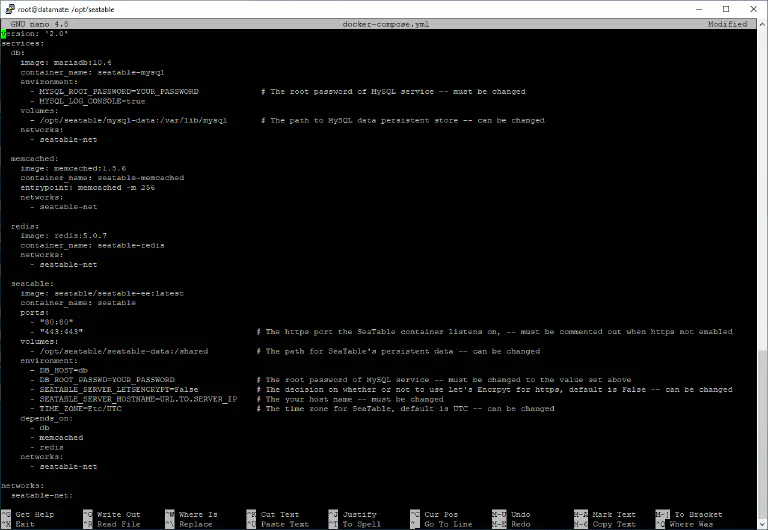

This is what the YAML file looks like after the download:
At first glance, you can see the four containers that Docker sets up when the recipe is executed: db, memcached, redis and seatable. For each container, the image to use (“image”) and the container name (“container_name”) are declared. The container name is the name by which the container can later be managed via Docker Console.
In addition, each container has a few individual settings, some of which need your attention now.
In the container db you have to change the database password. Replace “YOUR_PASSWORD” with a multi-character, alphanumeric password. In addition, you can adjust the path where the /opt/seatable/mysql-data/ directory is made available in the seatable-mysql container. By default, this is the path /var/lib/mysql. This is not necessary.
The memcached container and the redis container do not require any adjustments. If you are already running memcached or redis, you can remove these two containers from the Compose file. However, in order for SeaTable to run, you will have to make manual adjustments in the configuration files later.
The most extensive adjustments have to be made in the seatable container: First of all, the MYSQL_ROOT_PASSWORD must be entered there. Otherwise SeaTable cannot communicate with the database. So enter at “DB_ROOT_PASSWD” the password specified above for the container db.
Then it’s a matter of deciding whether you want Let’s Encrypt to request an SSL certificate for you and include it in the configuration of the web server. If you want to do this - which is probably the recommendation for most users - then change the value of the SEATABLE_SERVER_LETSENCRYPT key to “True” and enter the subdomain you use for SEATABLE_SERVER_HOSTNAME. The Certbot from Let’s Encrypt will then request an SSL certificate as part of the setup process and take it into account in the configuration of the web server.
You can leave the time zone set to Etc/UTC for Central Europe. If you are outside Central Europe, use the usual time zone codes.

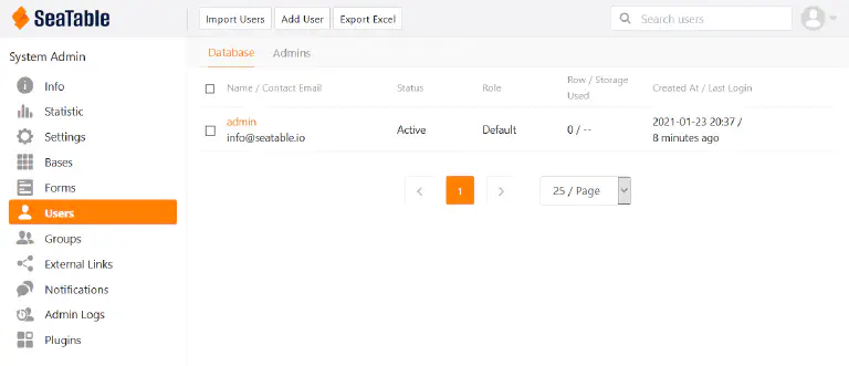

Execute the docker-compose.yml again. Unlike the previous step, docker-compose is now executed in the background or “detached”. After that you can start the SeaTable server in the Docker container seatable. Finally, you only need to create an admin user. Your SeaTable server is then ready for its tasks!
docker-compose up -d docker exec -d seatable /shared/seatable/scripts/seatable.sh start docker exec -it seatable /shared/seatable/scripts/seatable.sh superuser
After the last command, you will be asked to enter an email address and a password. Bravo, you have created the first user in your SeaTable on-premises system.
Commissioning #
Now call up the URL that you specified in the docker-compose.yml under SEATABLE_SERVER_HOSTNAME. You will land on the login page of your SeaTable server. Installation successful!
